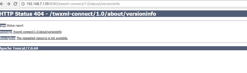

I have deployed ThingWorx Analytics and DataConnect on the same machine. It seems that the dataconnect doesn't work.
When i try the url "http://192.168.7.139:8080/twxml-connect/1.0/about/versioninfo", there is an error.

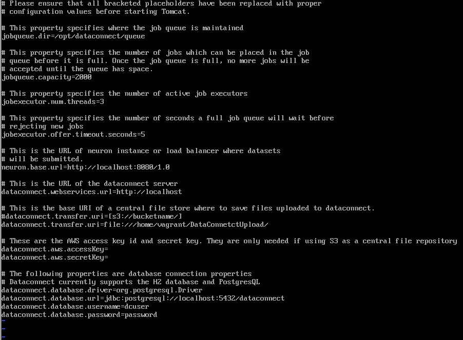

This is my dataconnect.conf.

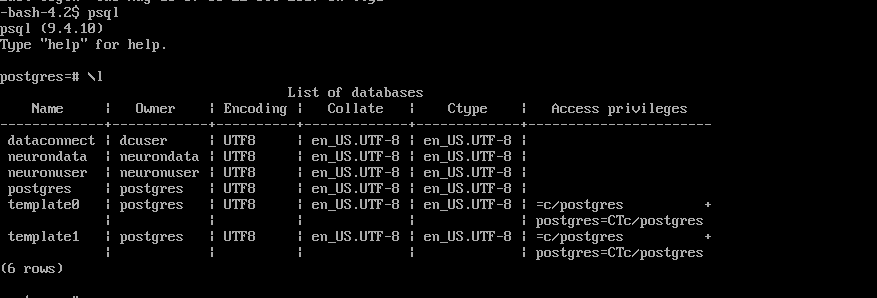

And the information about the database i used in the postgresql and the password is "password".

- in the browser you use 192.168.7.139 but in the configuration you use localhost ... was it because the browser is from a remote machine ?

The dataconnect.webservices.uri is probably missing the port number, but  I would not expect it to prevent the access as you have.

The application does not deploy properly because of this error:
"org.apache.commons.dbcp.SQLNestedException: Cannot create PoolableConnectionFactory (FATAL: password authentication failed for user "dcuser")"
So you would want to double check the password for dcuser in postgres.
Also please review the DataConnect user's guide. When using Postgres there are some additional settigns to be done that are docuemtned.
You are missing one entry in dataconnect.conf and I would guess the same is true for tomcat.conf
