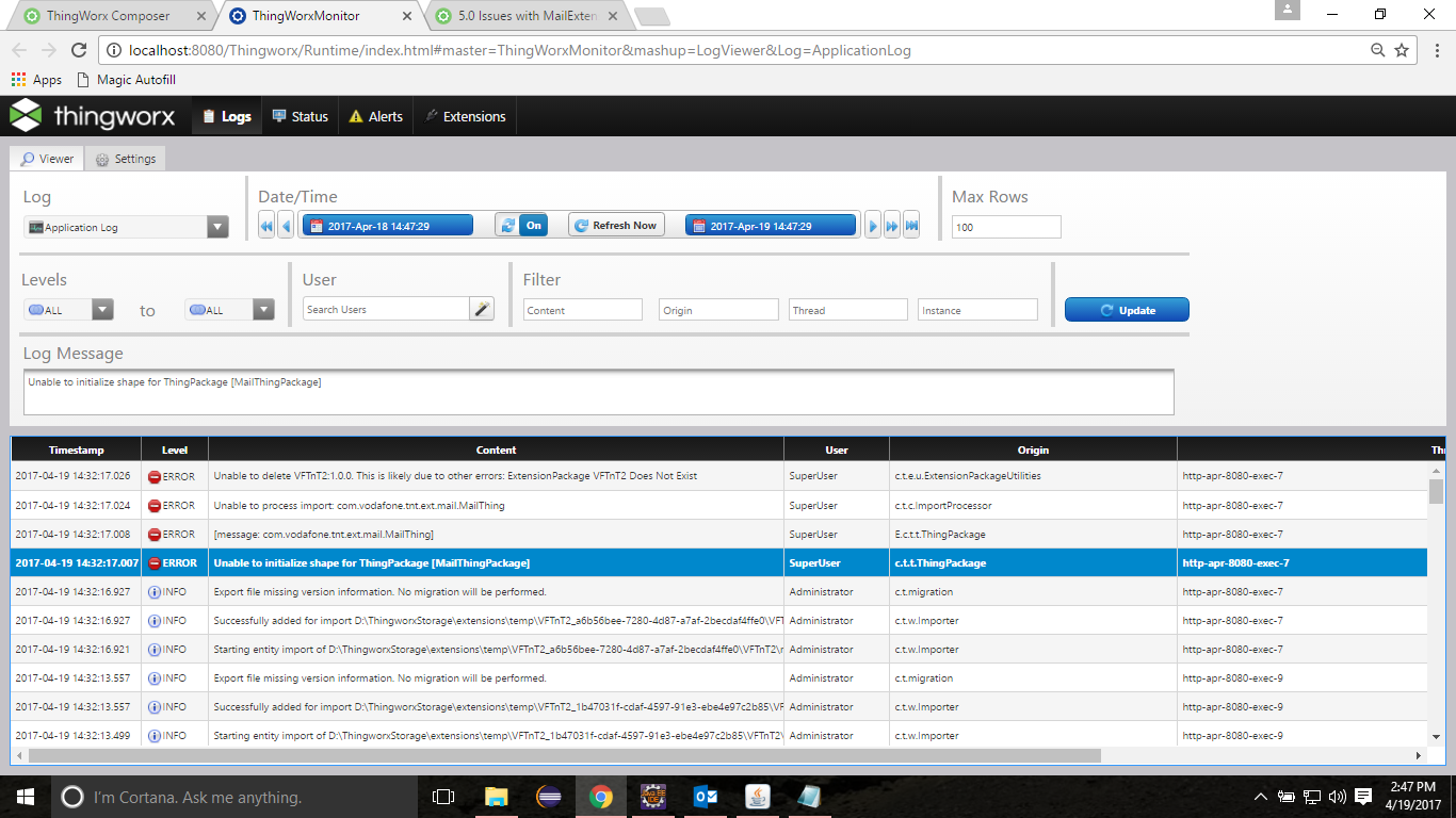

I have created one extension for Email notifications but unable to imported successfully and getting below application errors.
Attached the screen shot for application logs and meta-data file.
Adding to this i am also getting ClassNotFoundException in apache tomcat logs.

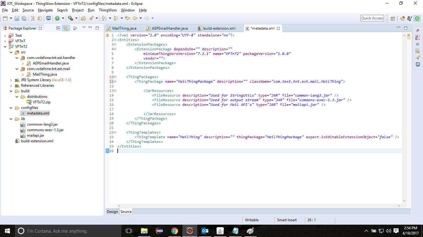

I think the className for your ThingPackage is wrong. I do not see the package given there in your project. Can you check this?
April 20, 2017
ClassName is correct. Please see the attached figure for your reference.
April 20, 2017
I do not see any package in your project called "com.test.tnt.ext.mail". I have seen the attached image, that is why I think the name is incorrect. Your package is called "com.vodafone.tnt.ext.mail"
