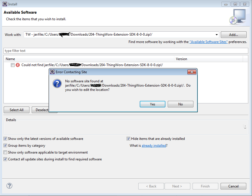

Hi Team,
I am using Thingworx 8.0 and want to import the extension plugin sdk in eclipse for this version of thingworx. I have downloaded '204-ThingWorx-Extension-SDK-8-0-0.zip' from the thingworx market place. When I try to import this plugin in eclipse Mars (version 4.5.1), I am getting an error. Please refer to attachments.
Please suggest.
December 6, 2017
Hi Pawan,
what you are trying to install is not the eclipse plugin but the extension sdk.
It seems like something is wrong with the marketplace download, since you get the sdk instead of the plugin.
For now you could download the previous version 7.2.0 of 'Eclipse Plugin for ThingWorx Extensions', it should work.
