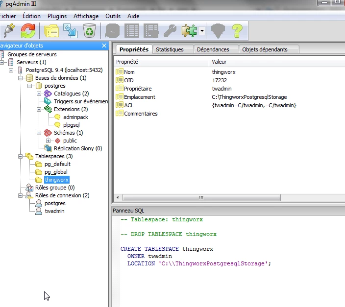

    imissaire1-VisitorAuthor
    August 24, 2017
    I added also rights to login and the login is ok now but I have : the database "thingworx" doesn't exist
    August 24, 2017
    and if it is an issue with 9.6, I will fully remove 9.6 and install 9.4 instead. I'am waiting / database thinhworx doesn't exist error
    August 24, 2017
    You could try deleting "PG_9.####" folder in ThingworxPostgresqlStorage and running the bat files again for the error.

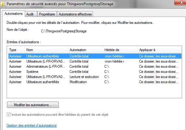

    August 25, 2017
    I have full rights  and always same pb
    August 25, 2017
    Is your ThingworxPostgresStorage folder empty?

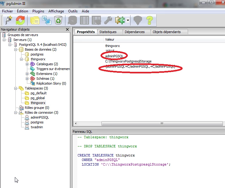

    August 30, 2017
    I have not twadmin like you but my adminPGSQL, created during installation : page 10, 3-b :
    b.Select NewObject>New Login Role. On the Propertiestab, in theRole namefield, enter the <PostgreSQL user role name>for PostgreSQL administration
    I have modifed the platform-settings.json : "username": "adminPGSQL" ... but same thing
    How can I change the thingworx in pgadmin to put twadmin like you ? bes=cause I use this adminPGSQL in . DBsetup and Schemasetup . bat
    and why create the 3-b ?
    August 30, 2017
    I have "2017-08-30 16:56:09 CEST FATAL:  authentification par mot de passe échouée pour l'utilisateur  « twadmin »"
    --> 2 admin twadmin configured and my adminPGSQL created as asked by the installation but I think we don't need it ?
    August 30, 2017
    Yes , you don't need it, just keep the postgres and twadmin users. Give the twadmin credentials in platform-settings.json.

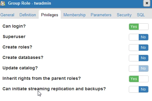

    August 30, 2017
    - I have update my platform-settings.json with only the postgres persistence provider package
    - I didn't create twadmin (neither postgres), it was already created. I updated rights to all for both.

    August 30, 2017
    Hi Isabelle,
    I'm sorry that you are facing all these issues .
    1) Could you please try removing the MSSql Persistence Provider package too, from the platform-settings.json?
    2) Then run the thingworxPostgresDBCleanup script file.
    3) Now delete the PG_9.4 folder in your ThingworxPostgresqlStorage .
    4) And finally run the thingworxPostgresDBSetup.bat . Let me know if the thingworx database gets created.
