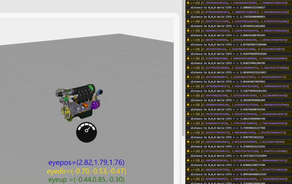

Is there a way to know how far the model is placed from us?
For eg. when I scan a object using model target and my model is superimposed over that object. Now I want to know how far am i standing from that object. And when I move around the distance shown should also change.
Any support or suggestion how it can be achieved will be very helpful.

Hi @vivekse ,
yes, this this is correct.  I checked it in a mobile project but it was not working stable.
So,I tested somethings furter and have now a mobile project where it seems to work now - means you will received the coordinates of the eye positon , gaze vector and the up vector.
I tested in preview (this is only simulation for mobile device- so that the results/values are not relevant) but I tested it also on IOS Ipad6 and was working with the current Vuforia Viewver version:

 $rootScope.$on('tracking', function( tracker,fargs ) {
 console.warn(fargs.position);
 $scope.app.params['eyepos'] ="eyepos=("+fargs.position[0].toFixed(2)+","+fargs.position[1].toFixed(2)+","+fargs.position[2].toFixed(2)+")";
 $scope.app.params['eyedir'] ="eyedir=("+fargs.gaze[0].toFixed(2)+","+fargs.gaze[1].toFixed(2)+","+fargs.gaze[2].toFixed(2)+")";
 $scope.app.params['eyeup' ] ="eyeup =("+fargs.up[0].toFixed(2)+","+ fargs.up[1].toFixed(2)+","+fargs.up[2].toFixed(2)+")";
 var scale=1.3;
 $scope.setWidgetProp('3DImage-1', 'x', ( fargs.position[0]+fargs.gaze[0]*scale));
 $scope.setWidgetProp('3DImage-1', 'y', ( fargs.position[1]+fargs.gaze[1]*scale));
 $scope.setWidgetProp('3DImage-1', 'z', ( fargs.position[2]+fargs.gaze[2]*scale));
 //3DLabel-1 no y
 $scope.setWidgetProp('label-distance-x', 'x', ( fargs.position[0]+fargs.gaze[0]*scale)+0.0);
 $scope.setWidgetProp('label-distance-x', 'y', ( fargs.position[1]+fargs.gaze[1]*scale) -0.08*5);
 $scope.setWidgetProp('label-distance-x', 'z', ( fargs.position[2]+fargs.gaze[2]*scale));
 $scope.setWidgetProp('label-distance-y', 'x', ( fargs.position[0]+fargs.gaze[0]*scale)+0.0);
 $scope.setWidgetProp('label-distance-y', 'y', ( fargs.position[1]+fargs.gaze[1]*scale)-0.08*4);
 $scope.setWidgetProp('label-distance-y', 'z', ( fargs.position[2]+fargs.gaze[2]*scale));
 $scope.setWidgetProp('label-distance-z', 'x', ( fargs.position[0]+fargs.gaze[0]*scale)+0.0);
 $scope.setWidgetProp('label-distance-z', 'y', ( fargs.position[1]+fargs.gaze[1]*scale)-0.08*3);
 $scope.setWidgetProp('label-distance-z', 'z', ( fargs.position[2]+fargs.gaze[2]*scale));
 console.info("distance to 0,0,0 World CSYS = :: "+magnitute(fargs.position[0].toFixed(2),fargs.position[1].toFixed(2),fargs.position[2].toFixed(2)) )
 $scope.$applyAsync();
In the parameter eyepos, eyedir and eyeup I created binding to the text property of the lables label-dinstance-x/y/z and are displayed there.

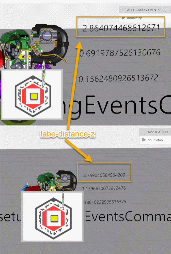

Hi @vivekse ,
thanks for the feedback, but as I see you did a little misunderstood my message, therefore, please let me explain.
Let consider what is the start setting:
  • You have a model widget and you need to have the information about distance to it.
  • The model widget has a specific position according to the world coordinate system. This is defined by the model widget properties for translations x,y,z and rx,ry and rz for rotations
  • What you could measure now is the current position of your device to the global coordinate system. And then you can calculate the position to the coordinate system of the model widget and  as I already mentioned in the previous post  “From there you can calculated the distance to e.g. modelItem or model references but you cannot find the distance to specific point e.g. on a surface .”
The mention post "https://community.ptc.com/t5/Vuforia-Studio/Get-surface-coordinates-of-a-model/m-p/646408#M7459" demonstrate  how to received the current position of your device.
In your case you have to add  to x,y,z, rx, ry, rz of you model to calculate the distance of your device to the model or (better) modelItem coordinate system - something like this:

$scope.setMyEYEtrack= function() {
 if(tml3dRenderer)
{ try { tml3dRenderer.setupTrackingEventsCommand (function(target,eyepos,eyedir,eyeup)
{ if (!$scope.check_if_works)
//check if setupTrackingEvents is working fine -at least one time called {
 $scope.check_if_works=false
//this below make sense only for testing $scope.setWidgetProp('3DLabel-1', 'text', "callback setupTrackingEventsCommand is OK"); }
//distance to eye
//moved the widget in regards of the new viewpoint position of the device
$scope.setWidgetProp('label-distance-x', 'text', ($scope.app.view.Home.wdg['modelItem-1'].x -eyepos[0]));
$scope.setWidgetProp('label-distance-y', 'text',
 ($scope.app.view.Home.wdg['modelItem-1'].y -eyepos[1]));
$scope.setWidgetProp('label-distance-z', 'text', ( $scope.app.view.Home.wdg['modelItem-1'].z -eyepos[2]));
$scope.$applyAsync(); },undefined) }
catch (e) {
$scope.setWidgetProp('3DLabel-1', 'text', "exception=");} }
else $scope.setWidgetProp('3DLabel-1', 'text', "null tml3dRenderer object on HoloLens");
////// finish setEYEtrack
So in the preview you can see the distance to the modelItem coordinates system / here consider the delta Z - distance in Z direction
I need to point here again that you can find only the distance to the coordinate system (0,0,0) of   particular model widget or modelItem widget. If the widget is small sized in this case, you can suppose that this is the distance to the element with enough good accuracy. But if the modelItem/ model widget refer to  geometry which is not small - in this case  the calculated value   is the distance to coordinate system of the item and has no much sense
