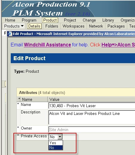

Re Private vs. "regular" in terms of Domains, I remember struggling with understanding this. The choice shown below (from Editing from the Details of the Product or Library) controls what Domain tree that context inherits from. Using Private for some allows you to put most ACL's at the Org level, then make some Libraries / Products private in order to not have them inherit from Org level (reducing total ACL statements by 90%). It is in fact a very useful configuration - just not documented in any clear way by PTC (and not well-explained by our GSO person at the time or by tech support).

Also, as to how to set Projects to be either "Private" or "Public", so that you can manage them in the desired domain tree...
The Project "attribute": Access Group determines whether or not the Project is Private. (Unlike the nice simple selection in PDM contexts.) If you choose the value "Team Members Only", the Project will be Private, and it's domain controlled appropriately. If you choose the value "Default", the Project will be non-Private, and it's domain controlled under the Org Default>Project domain.
