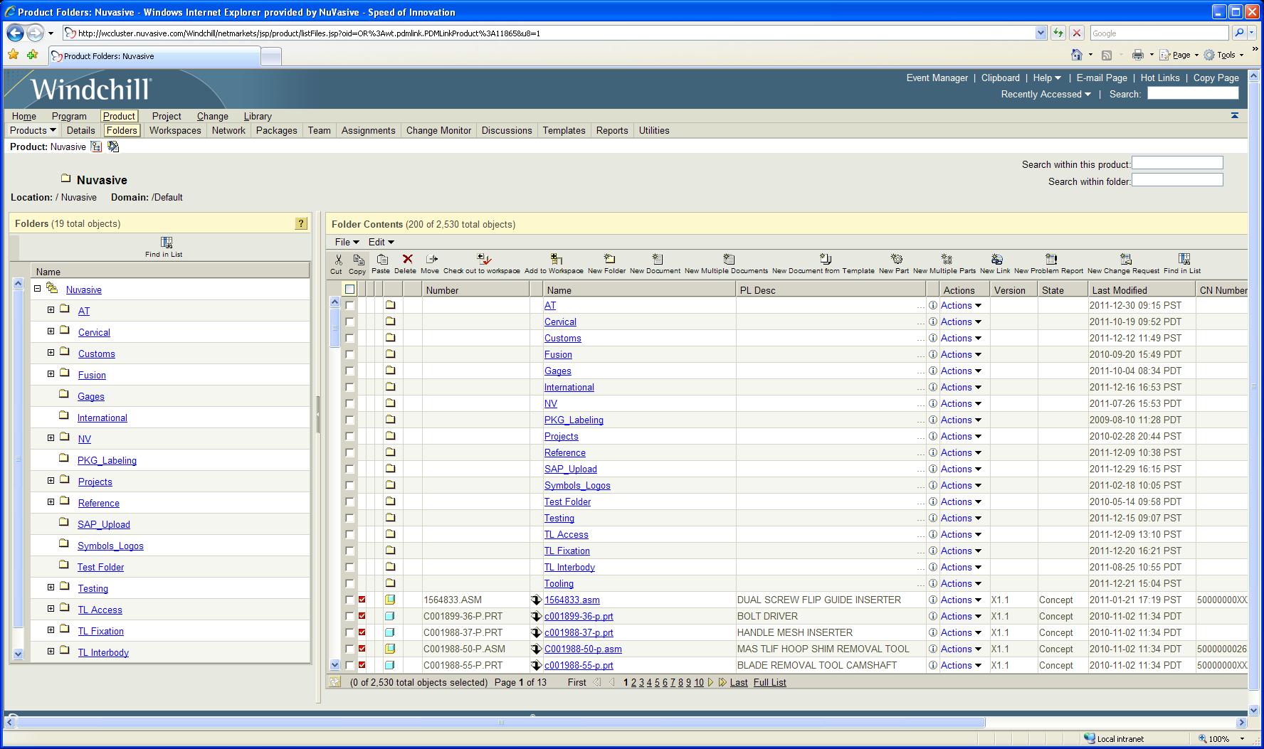

Sorry for the confusion but by personalized folder I meant project folder. Brian, you are on the right track. Currently our system is set up so that there is only one Product and under product there are project (context) folders setup. I know you can change the checkin location for the group as a whole but I want to vary the checkin for each user. I would like us to be able to manage our data better by project not by the user who created/modified it.

January 4, 2012
I think he's just got one monolithic structure with subfolders taking the traditional place of products. Hmm... a screenshot might help!
B.Champ1-VisitorAuthor
January 4, 2012
Here is a screen shot.
January 4, 2012
Hi Bon...
Is it true that Nuvasive is your only product?
Thanks...
-Brian
January 4, 2012
That is correct.
