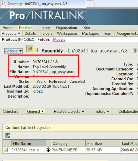

January 11, 2012
I am working through an Intralink 3.4 to 9.1 (10.0) migration and would
like to take the time to address a number of bad practices that I
inherited with the original implementation of Intralink 3.x. Primarily,
the release and CAD part naming process. Our site is currently document
centric and we have a Teamcenter implementation for the CM control of
drawings. As for the CAD objects we utilize as-stored configurations
stored Intralink. Our CAD part naming convention is a butchered
combination of part numbers and descriptions while our drawings follow
our internal numeric convention.
Going forward, I would like to enforce the use of "COMMON_NAME" for the
part description and have the ProE part name = the part number. The
issue of course is what to do with special characters. Mil standard
hardware for example shows up on the PL with "/" in the file name. I
would imagine the immediate solution would be to designate a parameter
on the CAD object called "part_number" and make it a string variable.
While that solves the issue of having special characters in the part
number, it doesn't prevent users from creating duplicate parts in the
database with the same part number and thus making it extremely
difficult to CM/revision control the models.
Can anyone offer insight on how to handle special characters in part
names or how to make a designated parameter in 9.1 a key field so that
the system ensures it is unique prior to a check-in.
Joe
January 11, 2012
In one of my previous positions, we attempted to follow the MIL standard for naming files. We were provided rules by the Army to be used in conjunction with the MIL spec. In all cases where special characters showed up that could not be used in the File Name or Number within Windchill, an underscore was implemented instead. This basically boiled down to all special characters except underscores and dashes being converted into an underscore.
The parameters showing it on title blocks and such were not tied to the Windchill attributes Number or File Name. It was left up to the individual to make sure they matched.

January 17, 2012
After working through this issue for the last couple days and reading
previous messages on the forum, the solution to the file naming
convention question jumped out at me. Again, my biggest issue was how
to handle special characters in CAD file names. I was fixated on using
a designated parameter from ProE for the part number but had concerns
maintaining uniqueness of parts. Ultimately I wanted a system that
could generate a BOM from CAD structure with the ability to tightly
integrate CM control of the CAD files (ie. limit the possibility of
duplicate parts).
The solution lies in turning off auto-numbering in the object
initialization rules. Once done, the user has the ability to rename the
Windchill number independent of the file name. With auto numbering left
enabled, the user can not rename the Windchill number field, it's grayed
out. Because the Windchill Number must be unique it would highlight
to a user if they were trying to create a previously revision controlled
part. This is also perfect because the Winchill Number allows special
characters and is used to generate BOM's. Bottom line, the system
enforces that both the number and file name must be unique. In the past
I never really understood the power of this until now.
With this in mind the use case for part numbering/naming would look
something like this:
1. Proe user creates new CAD geometry
a. User should attempt to name the ProE file exactly the same as
the part number to be displayed in the ERP system (if the OIR is
configured correctly the system will use this ProE file name to populate
the Number displayed in the PDM/Intralnk field).
b. If the part number is not known the user can enter any ProE file
name (the system enforce uniqueness)
c. If the part number contains special characters the user should
replace them with an underscore (special characters will be handled in
later step)
2. During ProE file creation use "Common Name" as the description
of the part
3. Save models in PDM Link/Intralink
4. Remember, OIR's are configured to populate the ProE file name
to the PDM/Intralnk number. Rename the number in PDM/Intralink for
those parts that the number was not known during initial creation or
that contained special characters.
Following the steps above and assuming you will be attempting to capture
a BOM from PDM/intrlaink you should have flexibility to name your ProE
files what you want, enter a separate description, and have a unique
parameter for capturing file names that would appear on a BOM. See
below for example screen shot.
Thank you again to all that sent me messages and helped contribute to
clearing this up.
