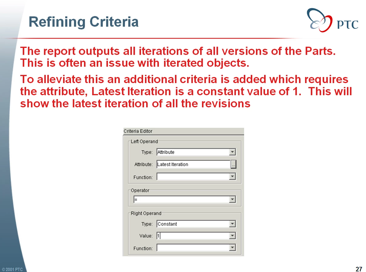

Below returns latest Iteration of each Revision.
Attached gives only latest Revision; needs latest Iteration also.

As Mike has already suggested you have to use a sub select to limit query returns to the latest version. Adding to the complexity this doesn’t necessarily work if you are using View versions on wtparts, if you are using views you will have to limit returns to just the view lineage you are interested in or perhaps add a Maximum sub-select on “last updated” if you just want the newest one. The query builder is also a little buggy when attempting to add criteria particularly in the sub-select, you have to add extra criteria then remove that before saving. Needless to say the sub select is expensive and I have had problems when using it with a large return.

Just one comment on this dead horse...
For reports on Documents, EPM Documents and Parts (Revisioned and Iterated), one has to use:
- Latest Iteration = 1
- Sub Select on maximum of versionSortID
For reports on change objects that are Revised, providing one is using Change Tracking preference (Revisioned but not Iterated), one has to use:
- Latest Iteration = 1 (this actually returns the latest Revision)
For reports on various configurations that are Iterated but not Revisioned (like workflow templates), one has to use:
Seems that all this should be in some documentation about query builder reports.
