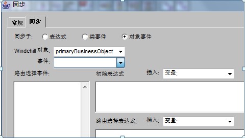

Open the workflow administrator and create ,create a workflow template to test a customerized workflow event on an object:
Without good luck,the event drop-down list can’t be opened in an synchronized robots:
My question is:What’s wrong with the event drop-down list?
