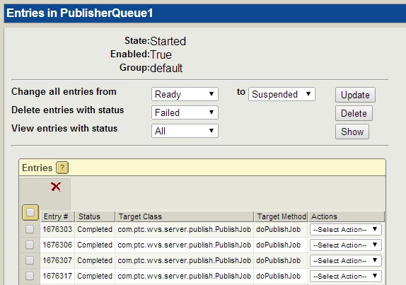

Does anyone know what happened to the ability to change the status of queue entries in WC 10.2? In 9.1 I could change the entries from "Ready" to "Suspended". Not seeing that in 10.2 Thanks.

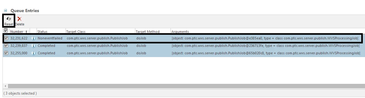

Use "Reset" button to resubmit "Noneventfailed" jobs in Windchill 10.X. As
per my knowledge "Failed" jobs in 9.X correspond to "Noneventfailed" jobs
in 10.X

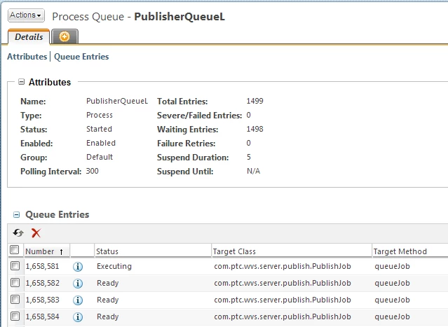

I guess I should clarify. I want to be able to stop publishing (delay for now) a large number of queue entries, but I don’t want to disable the queue altogether. In 9.1, I could simply suspend select entries. I don’t see any way to do that anymore.

I’m afraid that ability is gone in 10.x. I went through a couple cases with PTC tech support on this and really got a lot more into the working of queues than I wanted at the time. The state apparently wasn’t deemed useful. I’m not sure why you want that state but I finally got through to them that I wanted this “Suspended” state so I could terminate stalled or otherwise bad jobs. This isn’t possible by this interface in 10.x.
Just in case this is useful, my workaround (the PTC TSE agreed it is the only way he knew to do it) is one of two things.
1) If the job is already being processed by the worker, kill the xtop process associated with the job. Note that I have a configuration with each worker instance isolated and named so I can determine which xtop is associated with which worker (and thus job) by using Process Explorer (Task Manager could work too with the right column shown).
This will “fail” the running job right away. The queue will move along to the next job and a fresh xtop tree will start.
2) If the job is not at the worker yet but still “downloading”, there is no xtop to drop. The job also doesn’t follow rules of timeout in this state. The only thing I’ve found to do is to delete the downloading folder on the server (path shown in the WVS Job Monitor details for the job). It will likely re-create the folder.
It will not stop the job right away. What it will do is when the “download” is finished, the job will fail right away because of the missing files.
