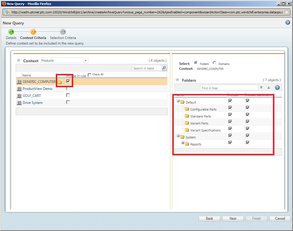

Hi
Is it possible to purge a specific folder of a Product in Windchill?
I can purge a Product
But can I select a folder of a Product to Purge?

Hello Kshetrabasi,
Basically, we cannot purge Products/Libraries/Organizations/Projects or even Folder. We only Purge the Windchill objects i.e. EPM Documents, Documents and Parts.
So as to Purge this object you first need to locate them into windchill.
Creating a Query means you need to select the Desired Product from Step No. 2 i.e. "Context Criteria" and once you select a check box against it, It will show you the Folder under that Product in the Right pane.
Now in Step no. 3 You need to Select the object which you are desiring to purge.
Find the attached snapshot for more explanation.
Let me know if you need more details.
~Harshal

Hi Harshal,
While making a new query for purge manager; there are there steps
1.Details
2.Context Criteria
3.Selection Criteria
In the Context Criteria there is option to select or exclude Products
I excluded all products except One Product; Resulting in Purging only One Product only

Hello Kshetrabasi,
~Harshal
