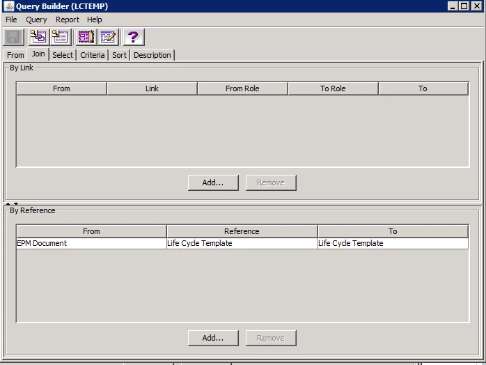

Hello
I am working on a report that captures the Life Cycle Template of an EPM Document via the Query Builder, but I am struggling to add the correct "Join"/link between the two object Types.
From your knowledge of how the database is built do you know how I could create the link? From what I understand, the Query Builder accesses the database tables to retrieve the data, for example, to create a link between EPM Documents and WTParts the "Join" in the Query Builder is:

I have tried several variations of the above to try and create a correct link between EPM Document and Life Cycle Template (wt.lifecycle.LifeCycleTemplate) but I cannot get any results.

I forgot to mention that I am interested in the iteration of the life cycle template. I need to find out which EPMDocument is using which iteration of a given life cycle template

See attached QML.
Hope this helps !!!
Shreyas
February 10, 2014
I have created report in Windchill 10.2. so not sure if you are able to import it on Windchill 9.1.PFA attached screenshot of join.
Shreyas
cc-21-VisitorAuthor
February 10, 2014
Hello
thank you very much for your prompt reply. It works perfectly.
