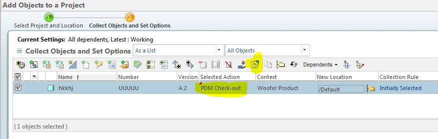

We've only really used Project for sharing a copies of files with end consumers. For example the manufacturing shops.
We are now looking at using it for a more collaborative process.
We have two classes of users.
A. Those that have access and modification permissions to files in the Product
B. Those that only have access to a Project
User A will share files to a Project from a Product. That user B will use to develop other files. Typically they would not have modification ability to the files shared from the Product.
When these additional files are done and we want to manage them in the Product, they get Sent to PDM.
Now the question come up when user B wants to make a change to that object how to we give them permissions to do that without giving them permissions to the Product.

Hi David, ProjectLink handles this pretty well.
1- User A shares Drawing 12345.drw - B.2 to a Project
a. Instead of just doing a "Share" you can select "PDM Checkout" instead
i. [cid:image001.png@01CFA755.939D44D0]
ii. This doesn't actually check the object out, it just allows other PROJECT users to perform a checkout/checkin
2- User B can now check out the drawing, edit it and check it in.
3- User B's modifications ARE NOT published to the PDMLink Product...yet
a. They remain ONLY in the project at this time
b. Multiple iterations are made and they are tracked differently if I recall correctly
i. B.2.1
ii. B.2.2
iii. B.2.3
iv. The iteration in bold is the PROJECT iteration
v. When B.2.3 is finally checked back into PDMLink via a "PDM Checkin", it will only show B.3. All of the other ProjectLink iterations are not kept. It just checks in the latest modification.

I'd encourage you to read the Windchill Help Center topic "Use Case Scenario for PDM Checkout." It covers several possible scenarios for using PDM Checkout. (I've also attached a slightly updated copy below)
One example of how you could use PDM checkout :
1. Product User A shares File1 to a project.
2. Project User B uses File1 to develop a related document, File1-2
3. User A performs the Send to PDM action to add File1-2 to the product
Option 1 -- From the Send to PDM window, select File1-2 and click the Keep Checked Out option.
User B can continue to modify their project-specific version, but the File1-2 object in PDM won't be affected until/unless you explicitly perform the Send to PDM action again. If you later decide that you don't want to include any of User B's work, then you can perform an Undo PDM Checkout action or the Convert to Share action.
Option 2 -- From the Send to PDM window, select File1-2 and click the PDM Checkin option.
Convert to PDM Checkout action.
Regarding access -- You would still need User A to perform step #1 and step #3. But after the initial Send to PDM action is completed, and provided that the object is being shared or is checked-out to the project, you can grant ad-hoc permissions on an object-by-object basis.
This would allow project users to perform various PDM checkout actions, including Send to PDM, without granting them access to the product or allowing them to view product-specific information. See the "User Permissions" section in Permissions and Valid Object Types.
