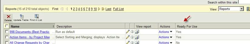

Is this box checked (from Site, Reports)? May have to scroll to see it.
[cid:image002.jpg@01CD5438.A18D0D90]
You can add a column that shows this checkmark to the Site level Reports table. Probably should be there OTB.
[cid:image003.jpg@01CD5438.A18D0D90]
Attached by the way is a Report Template of Report Templates - but I can't figure out how to include a column listing this checkmark here. Note: The same report is supplied OTB, but it is labeled "Domain Reports" and no one knows what that means.

Hi Mike and the rest of the solutions group,
Well, Mike, you kicked the dust out of my head and gave me something to
think about, so I finally got a solution. Maybe not the best, but a
solution.
Your emphasis on the Site context got me to thinking.
So I removed the reports from the Organization context and imported them
into the Site context. Reset all the switches just as I had in the
Organization context and just like magic, my users can see and use the
reports.
