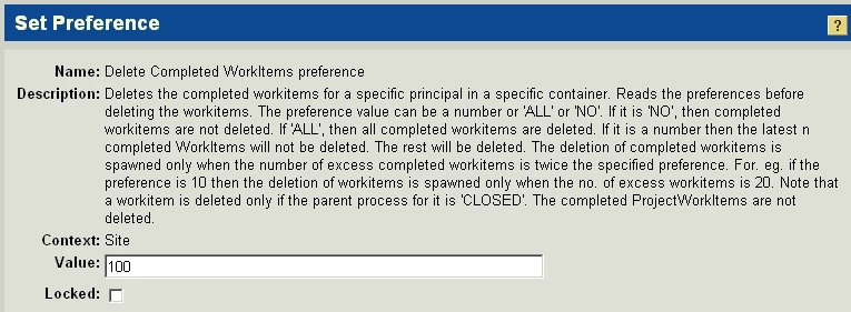

Be careful here on one thing...
Work Items are temporary - the system delete them (default is 100 at a time, controlled by a preference). They are perfect for reporting work in process but cannot be reported on after completion.

January 15, 2011
Thanks for the tip. In this case the work item is perfect because we are only reporting on incomplete items.
