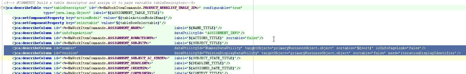

Yes,
Just completed a minor customization:
We want to have PBO number and rev available as possible fields to display on the assignments pages (Home, Product, and Library)
EX:
In site.xconf add:
<service context="default" name="com.ptc.core.htmlcomp.tableview.ConfigurableTable"&lt;br"/> targetFile="codebase/com/ptc/windchill/enterprise/enterprise.service.properties">
<option<br/> serviceClass="ext.baesystems.enterprise.work.BAEHomeOverviewAssignmentTableViews"
selector="netmarkets.overview.assignments.list"
requestor="java.lang.Object"
cardinality="duplicate"/>
</service>

Update the following jsps:
netmarkets/jsp/work
listOverviewAssignments.jsp
listProductAssignments2.jsp
listLibraryAssignments2.jsp
like so:
[cid:image002.jpg@01CAB6FA.CB6F03D0]

Here is some info from a PTC TSE as well. We followed their solution with only a minor deviation.
You can customize the listOverviewAssignments.jsp page to add the 2 custom columns like below. The OOTB NumberDataUtility and VersionDisplayDataUtility should be able to render these columns for you.
<jca:describecolumn id="number" sortable="${sortable}" isinfopagelink="false" datautilityid="NumberDataUtility" targetobject="primaryBusinessObject.object"/>
<jca:describecolumn id="version" sortable="${sortable}" need="iterationDisplayIdentifier" datautilityid="VersionDisplayDataUtility" targetobject="primaryBusinessObject.object"/>
You will also need to add the 2 columns to your Views. The OOTB Views for this Assignments table are defined in HomeOverviewAssignmentTableViews.class . you can create a custom class similar to this, modify the getSpecialTableColumnsAttrDefinition method to add the new columns.
public List getSpecialTableColumnsAttrDefinition(Locale locale)
arraylist.add(new com.ptc.core.htmlcomp.createtableview.Attribute.TextAttribute("number", "Number", locale));
arraylist.add(new com.ptc.core.htmlcomp.createtableview.Attribute.TextAttribute("version", "Version", locale));
The Views should now show up when you click on "Customize View". You might have to delete the existing views, clear Tomcat cache and restart Windchill to pick up the changes.
