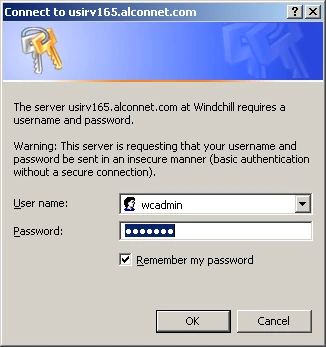

Also, <windchill>-Solr brings up a login screen; it's supposed to bring up a "web app" for Solr. Tech support hasn't been able to provide the username / password (we tried every combination we could think of). Anyone know what it is or where to find?

So, a bit more info on this....

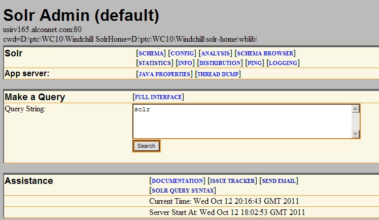

The username / password is in fact wcadmin / wcadmin, but with active directory integration, separate Apache conf files need to be manipulated to have both A/D and this working. Once you log on, a complex UI is available. So far, haven't found a single word of documentation from PTC on this UI.
We reset everything again, and again the process quickly gets to something over 36,000 objects processed, then simply stops progressing. Have set all possible to verbose and lots of summary logging now occurs (including the set of SQLs that together result in the total object count), but nothing that indicates specific objects that have been processed. The UI does not appear to have any way to drill down to where it got stuck.
