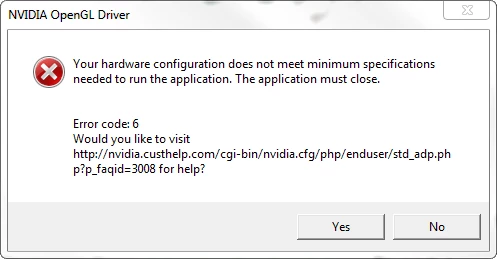

Hey Everyone, Happy Friday!!
I have a Windchill 10.1 user (no Pro/E) that gets an error from the video system when he tries to print from Creo View 2.0 Anyone have a solution or insight? The general process is that he searches for and opens a drawing in Windchill 10.1, clicks on the print command, switches the paper size to B (11x17), and tries to print, but gets the error instead.
The error is:
NVIDIA Open GL Driver
Your hardware configuration does not meet minimum specifications needed to run the application. The application must close.
Error code: 6
(See screenshot.)
[cid:image001.png@01CF5A1E.EE0C0E80]
-marc

Hi Marc,
This is a known issue with Creo View and certain graphics cards. The simplest way to solve this is to set an environment variable of PV_OFF_SCREEN_SIZE_LIMIT to the value of 2048. I know it sounds strange, but it solves the issue. This is basically a hidden option that's controlled through an environment variable instead of the settings menu.
You can copy the text below into a file and give it an extension of .vbs if you want to automate setting the variable.

Hey Brian,
Thanks for the suggestion.
To test it, I typed in:
SET PV_OFF_SCREEN_SIZE_LIMIT=2048
But still got the error... any advice?

Thanks to Brian, I got this to work. As Brian pointed out to me, typing the SET command into a command window only enables the variable for that window, not for the whole session. I ran the script he sent along and it fixed the issue.
Thanks again, Brian!
-marc
