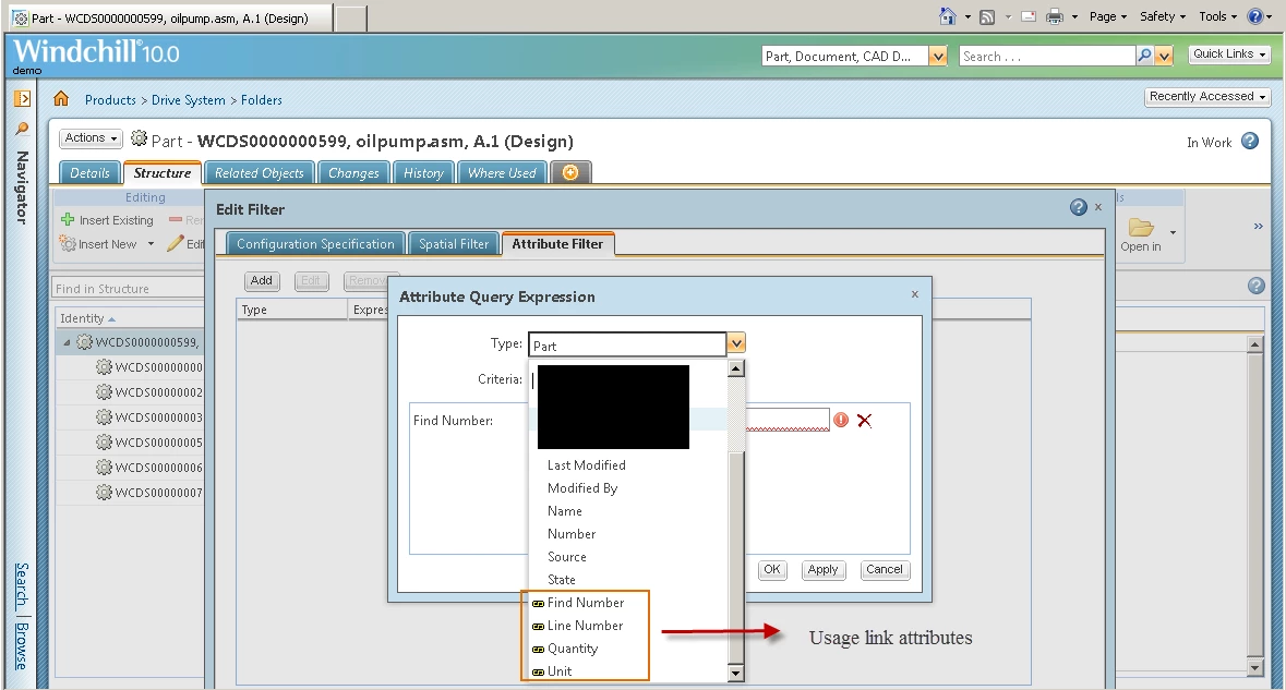

Hi Karan
R10 Structure browser has a tab for filtering the structure based on the
attribute values. Please refer the attached screen shot that shows the
filter selection based on usage link attributes. In your environment, do you
see your usage link as one of the selectable attributes.
Swamy Senthil
Swasen Inc.

Hi Swamy,
Yes you are correct about Attribute filter in R10, but Attribute filter will filter the Product structure with those whose values match to Attribute provided.
My requirement is not to filter(as done with Attribute Filter) but display it with Part Master icon if it does not match the criteria of WTPartUsageLink Attribute.
The part Master icon is displayed for Configuration Specification filter if applied(see below description)
A part mastericon is displayed when there is no part version satisfying the configuration specification criteria. The presence of the part master icon indicates that the configuration is incomplete. In other words, the parts displayed in the part structure do not constitute a complete bill of material for specified product configuration.
Is there any way to write any custom filters which satisfies the above criteria.
