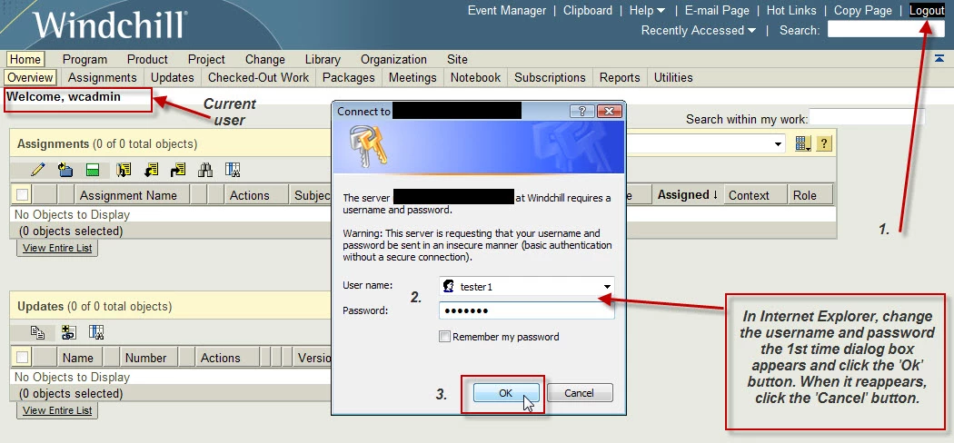

Greetings,
Per the hot topic posted this past Friday "How to logout of Windchill?" I am posting some customized source code that will readily work in 9.1 and probably 9.0. As for 8.0 and earlier, it will work, but getting the logout link to display is another tweak I have yet to make.
Please review the PowerPoint presentation I am providing. I also attached it in PDF format. It explains how the customization works in Internet Explorer and FireFox. It also explains how to configure your system and where to place the files.
Attached is also the java source code that makes this work. I know some places need to see it before they can get permission to install it.
Enjoy!
