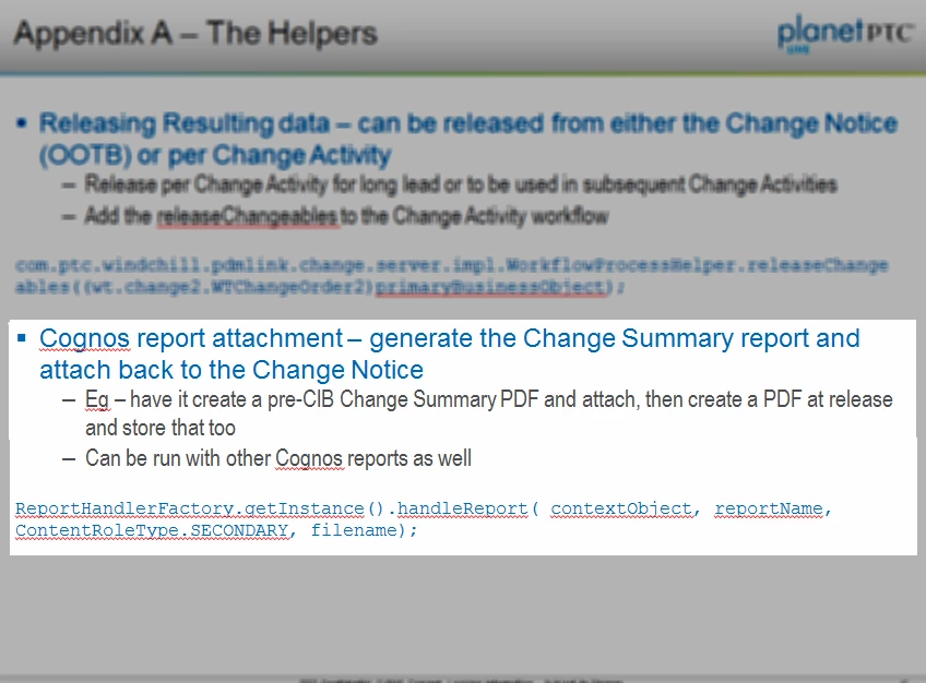

Russ,
One option is to use the Cognos Change Notice summary report which will get you all of the Resulting objects and lots of detail about them. We introduced automation in 10.0 M20 (I think it was M20 - but need to verify). This will create a PDF file and attach it back to the change. You would then need to create a link or add the attachment to the workflow - but generating the report is automated.
[cid:image001.png@01CEB613.639D4C50]
