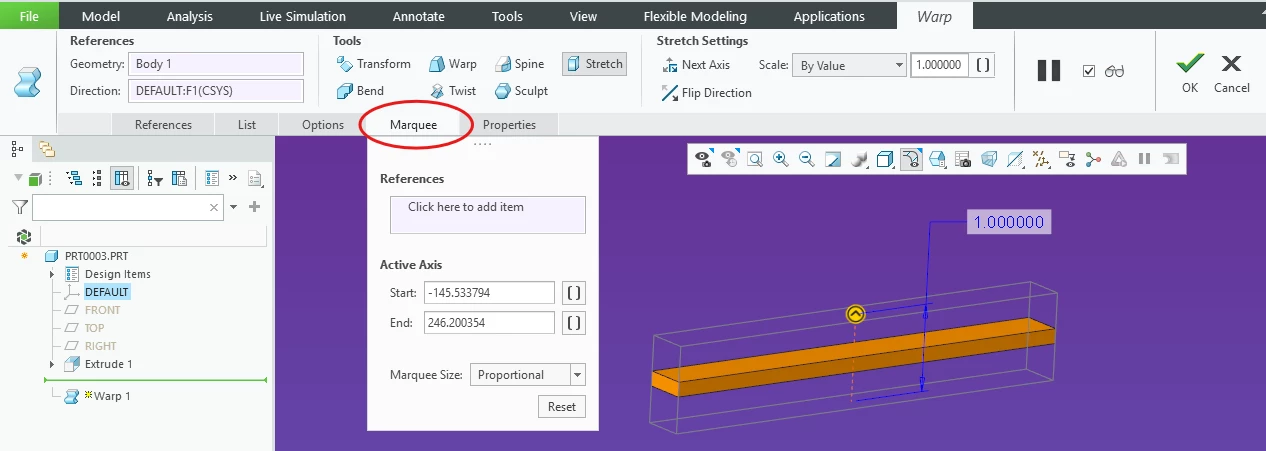

扭曲命令中的选取框如何与实体完美贴合
  • September 19, 2026
  • 49 views
我画一个300*30*10的长方体,想尝试一下扭曲命令,发现尺寸为10的方向,选取框无法与实体完美贴合,而另外两个方向是可以的,如何才能使尺寸为10的选取框完美的贴合实体,单位:mm
kdirth
September 22, 2026
I would guess that the settings in the 4th tab have been changed through dragging the box on the screen.  0 and 100 would be the default numbers.  These control the limits/measurements of the warp.
