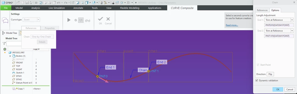

kdirth
Oct 27, 2025 12:59 PM UTC
Your request is a bit vague.  Is this what you are trying to do?
References / chain details / options: Change each end to trim at reference and select the desired reference (point, plane, line, edge, surface, etc).
