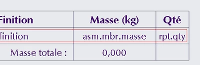

On the Creo 2D drawing, For the Sheetmetal fabrication BOM table, is it possible to show weight of each component and total final weight?
RaphMORINAnswer
Sep 30, 2024 1:36 PM UTC
Yes you can, using a repeat region. In that region you can call the mass parameter of each part using asm.mbr.masse if your parameter is masse.
In the assembly I create a parameter adding all these weight and show it at the bottom of the table.

Oct 1, 2024 5:55 AM UTC
The BOM table, does it allow to sum all mass at last column, like excel, do you suggest any formula
Oct 1, 2024 6:23 AM UTC
in assembly BOM user can use functionality described in https://support.ptc.com/help/creo/creo_pma/r9.0/usascii/index.html#page/detail/To_Get_a_Summation_of_Parameter_Values_of_a_Repe.html document.
Unfortunately I do not know how Sheetmetal fabrication BOM table is made.
