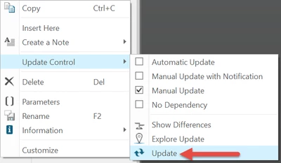

January 8, 2020
I'm replying to this relatively old thread hoping it gets bumped and noticed.
Does anyone know of a solution for updating the data sharing features that have been set to "manual update" other than turning them to be "automatic", regenerating and then turning it back to "manual" (and regenerating)?
It's rather annoying especially if you are dealing a model that takes half a day to regenerate...
For copy geom features, then the right-click menu provides a convenient shortcut to toggle the automatic / manual update and you only really need to do the regeneration once.
However, if you need to update a merge feature, this takes 2 edit-definition steps and hence 2 regenerations...
January 9, 2020
I would add only one thing:
Copy Geometry: If the customer has Design Exploration (DEX) license, then has option Update on Right Mouse Button.
Shrinkrwrap feature and Merge/Inheritance: No option Update on Right Mouse button.
As written in previous post, for Shrinkwrap and Merge you have to Edit def > Automatic > Regen > Edit def > Manual > Regen.
January 9, 2020
Thanks for replying.  So it is as I suspected.  It's nice that the new features (DEX) have user experience enhancements, but I wish PTC would go back and improve the old features as well.  I'll see if I can raise a product improvement idea (I don't have a maintenance account).
