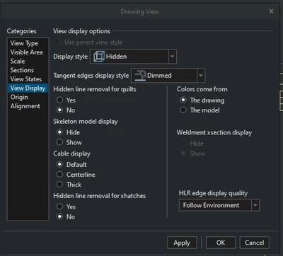

I am trying to display wire endpoints in a section view of my cable assembly & only the centerline will display, Even when I exclude the harness.prt from the section view in the model it only appears when it is not behind a sectioned area.
Everything I find online suggests: Drawing View → View Display → Cable Display→Thick but that does not resolve my issue. Any help is appreciated!

I'm a little unsure of what you mean, but I find that when I'm making cabling drawings, sometimes I have to set the view display to hidden and then regenerate to get some things to work.  Sometimes I run into issues with the shaded options.
