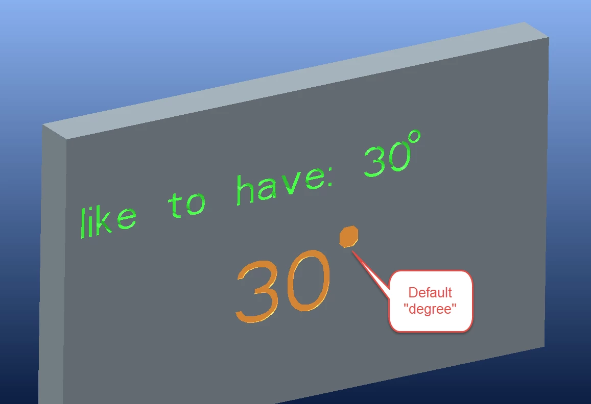

I want to mill text in steel. The text is 30 "degrees"
With the font3d (and all other 3d fonts) it gives a circle. But what I would like to have is a "tube" geometry, with inner and outer diameter. Of course I can add another feature but I would like to have it in the same sketch. See .png attached
Enhancement request? Or am I missing something?
It's for Creo 2.0 (with 4.0 coming up). Ruben
Best answer by Pettersson
Maybe just draw it with two circles? If you make the text right-justified you should be able to dimension the circle from the end of the text, so it's not dependent on the value for a correct position.

I guess it is possible to modify the degree character definition in the 3D font.
RubenPas1-VisitorAuthor
January 22, 2020
Yes, that is indeed the fast way that I took. I will take a look in the font, as Martin mentions.
Thanks guys! I appreciate your reaction. Ruben
