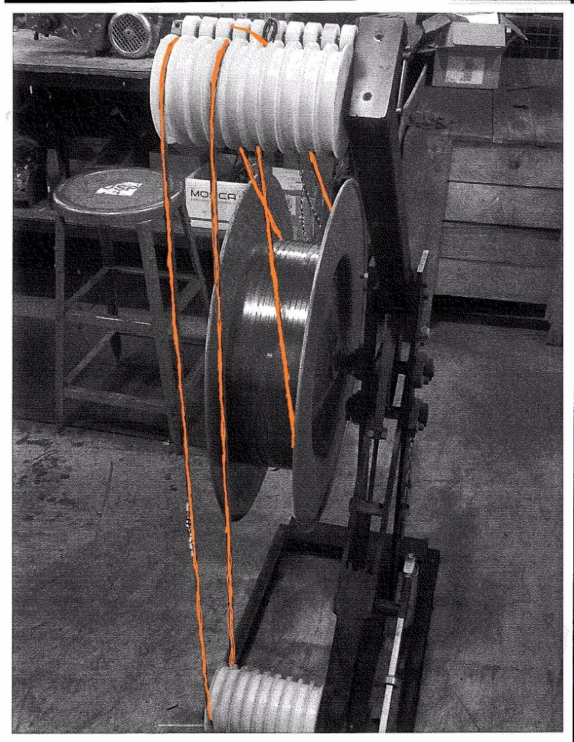

I am still new proe user. I spent a lot time to make this model, but could not get it. Anyone would like to help me?
I want to create a 3d model which is a strip 12 mm x 0.3 mm on section. Strip will be pull from dispenser, and go through 4 wheel.
see the image below:
Attached coil file which including coil feature and copied face of 4 wheels.
I appreciate your help.

I didn't open your file, but would try to create a datum curve that goes through all the necessary pullies and then use a sweep protrusion 12x.3 using the constant cross section option, that uses the datum curve as the driver to generate the model.  As you create the curve, you will need to maintain tangency throughout - or the model will fail.
I think if you can get a single curve that is nice and tangent all the way through, then it should only take two features to create the entire model.
