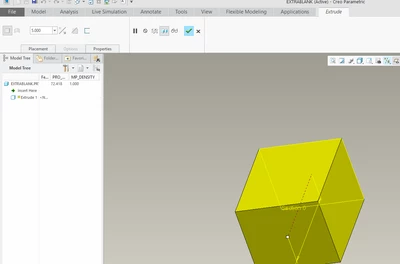

Creo is a funny beast. At least on Creo 4, you can start an empty part (no planes or datums) and then you can Extrude or revolve a feature with no references. I didn't really know this was possible until I just tested it.
But if you have a coordinate systems as a default, you CAN'T do anything unless you add default planes (as best as I can tell).

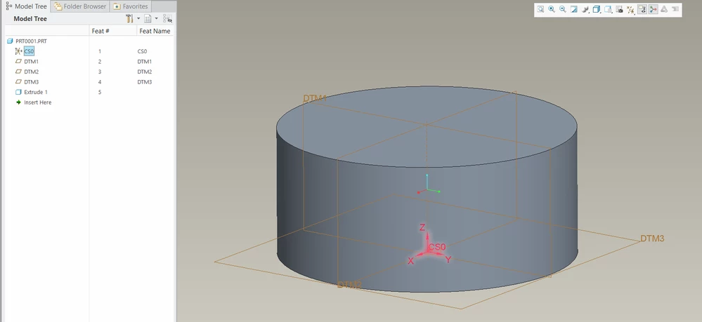

I can confirm that extrude and revolve are possible without datums present in the model in Creo 4. There may be other features possible as well.  Sketched curve is not available for me. You can see that Creo is using an internal origin reference to place the extrude or revolve once you complete the feature.
Suppress the extrusion and then create a default csys and planes. Then resume the extrusion (which is not dependent on these datums) and you can re-order it to the end of the tree. Note that the proximal plane used to create the extrusion is aligned with the default Csys and the sketch plane is in the XY plane.

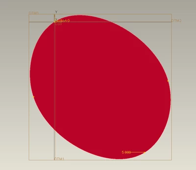

Interestingly, when you extrude and start that sketch, you can "pan" around in the empty model, but that first sketch click you make becomes the default origin of the model. I tried to fool it by sketching something random at first, then sketching another item and deleting the first sketch but first click on the used sketch became the origin. Even a spline uses that first click origin but orientation is a mystery so far.
