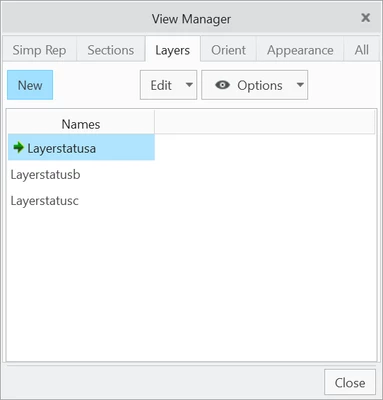

3D model Layer hide/unhide
can we use pro/program or any other method to hide/unhide layers as per the input we are giving  in Creo 3D model?

joe_morton
Jun 6, 2023 3:35 PM UTC
Not sure if this meets your needs, but have you tried this? In View Manager, you can save different Layer states and then switch between them:
7-Bedrock
Jun 15, 2023 7:45 AM UTC
Thanks. But this I could not control the layers using pro/program
