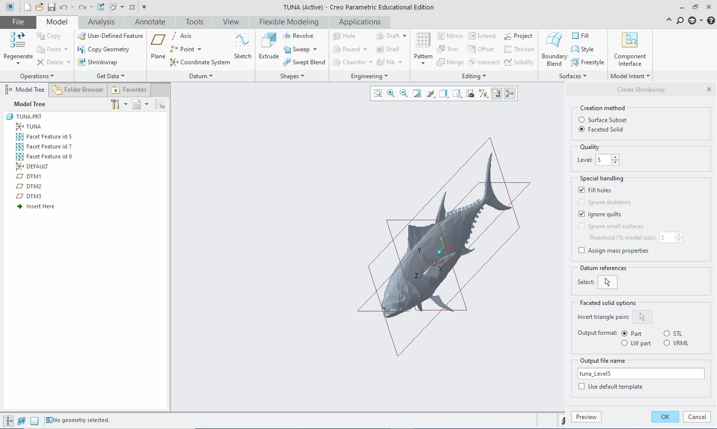

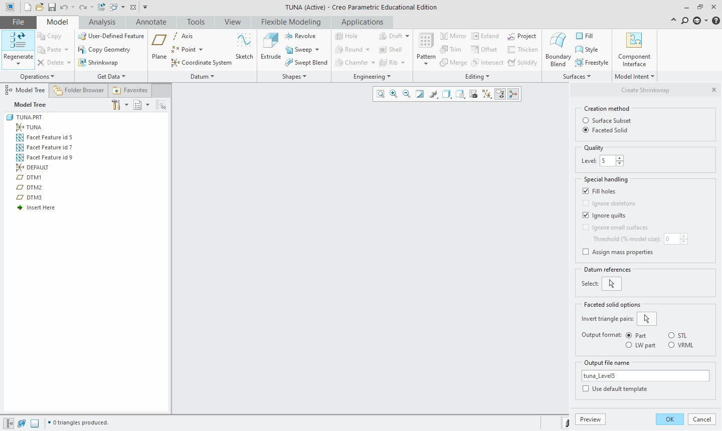

I can get as far as 1:16 in that video following the steps detailed to create a skrinkwrapped model, as seen in Capture1 below, however as soon as I attempt to click okay the geometry disappears and I receive the message 0 triangles produced. This happens regardless of what Quality level I attempt to use. Has anybody any experience with receiving this message? Does anyone know of a solution?
This is now added to the long list of different attempts I have done changing this .obj to a solid .prt, this is why I conceded defeat and attempted to create my own without much luck...
