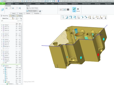

Hi Guys,
Anyone else having issues with Creo 7 and 3d section views?
I want to create a section view in my 3d part to measure some the thickness of my part.
Im making an offset section, as I want to create a sketch of where it is.
It shows fine in the preview.

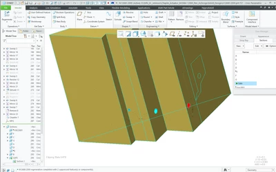

But once I accept it, I get this crap. Its like it doesnt hide my sketched curve, and trys to create a solid from it.
Ive been using Creo since the Wildfire days, and it seems Creo 7 is SO buggy.
Is there a config setting to stop this from happening? I NEED to have this right on the center of some geometry to get a good measurement....so moving it slightly offset till it works is not a good solution.
