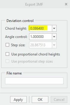

Make sure to have the customize export box checked. Then when you save, change the chord height to 0. Creo will then automatically change it to the minimum size it can produce. I also change the angle control to 1 although I don't think that has a big impact. 1 gives you more tessellation.

Chris321-Topaz IAnswer
