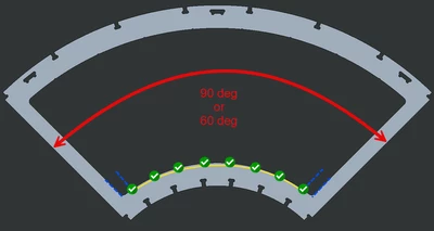

I'm using Creo Parametric 9.0.6.0.
I'm looking for help finding out the name of the calculated angle dimension in a pattern.
I have a part that has a specifiable angle, 90 or 60 (red arrow). I need a different quantity of features (green check marks) depending on the angle of the part. These features must also start a specific distance away from an both inner edges. In order to pattern the features I created a curve (yellow line) at the constant offset from the inner edges (blue lines).
In the pattern, my driving items are the curve and the number of features I want the pattern to have. It gives a resulting angle dimension between features (2nd image, red box), I'd like to use that value to show in the family table or show on a drawing. Is there a way for me to link to that value, does it have a name hidden somewhere?

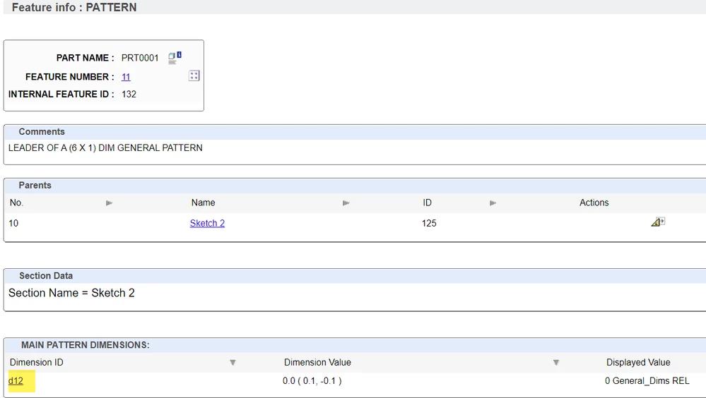

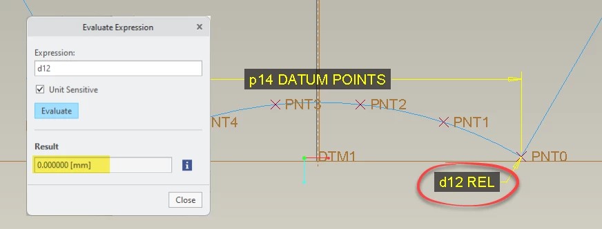

It appears based on your original post that you are placing the pattern members on a curve using the option to specify the # of members, I am almost certain that this spacing dimension has units of length in which case there is no angle dimension defined in the pattern explicitly. You can verify this using the relations editor as shown below for the dimension driving your pattern spacing. If this is the case for your pattern, then the answer to the question is there is no angle explicitly defined in your pattern.
You can also use feature info on the pattern to display the dimensions driving the pattern.

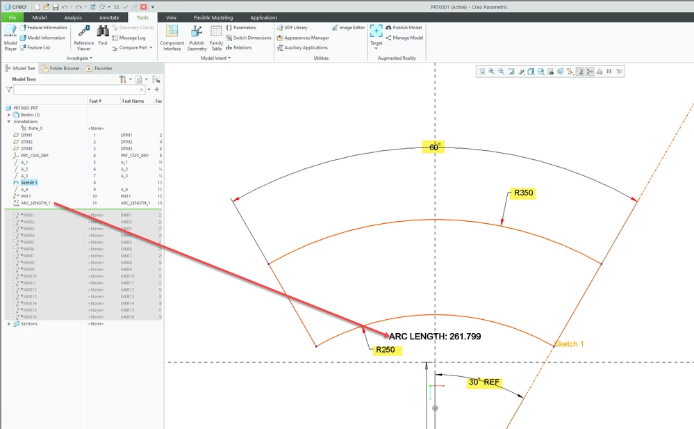

The angle can be included in a feature creating the geometry of the part, it is probably already in your model. The arclength can be measured and managed by creating an analysis feature.
As an example, all features highlighted in yellow belong to the sketch feature and the arc length is measured by the analysis feature. This setup will enable you to drive the pattern using relations to space the members required based on the angle. The angle and arclength support setting the pattern spacing using either or both of these dimensions.

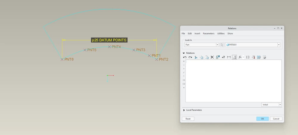

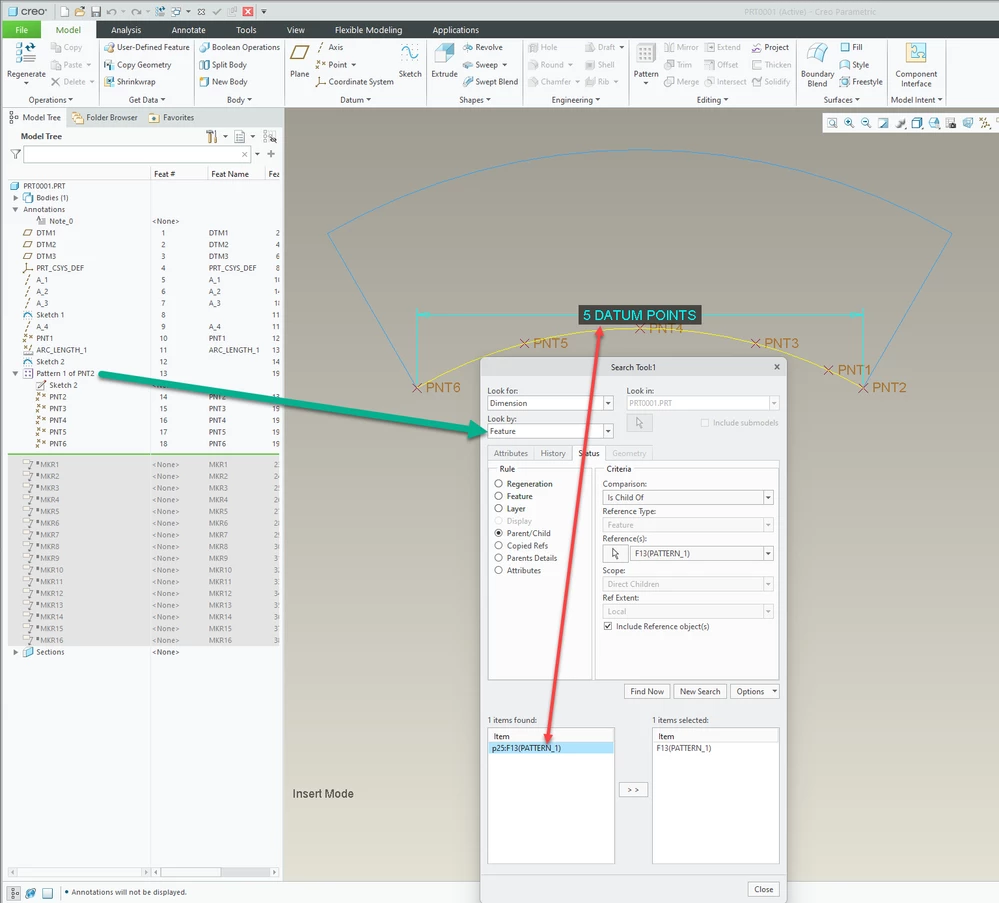

To answer your question directly, you can use the search tool (binocular icon in the UI) to find the pattern dimensions for the pattern already in your model. Here is an example of how to build a query to find all dimensions that are a child of a specific pattern to find the dimension of interest.
You can also invoke the relations editor with the pattern dims displayed in the graphics window to find the name as shown below.
