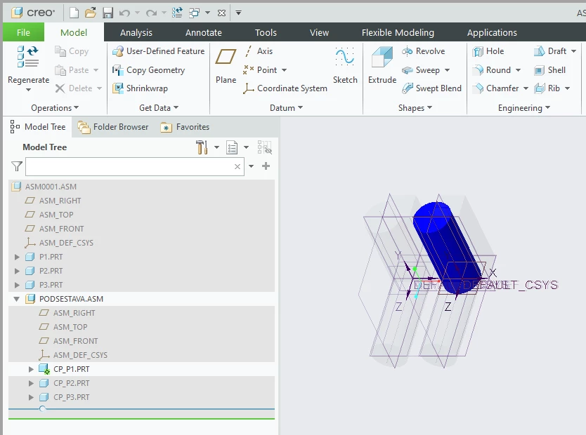

Community,
When I activate any one of the models in the model tree, it will not activate, and the entire assembly remains the default gray.  I am using Creo 6, and I have never encountered this type of problem before.  Has anyone seen this type of problem, and is there a fix for it?  Thanks in advance.

I am not able to reproduce your problem in Creo 6.0.4.0.

I figured out the "problem".  If you go to Options>Model Display>Enable Transparency, and if you uncheck Enable Transparency, you will see what I mean.  I had it unchecked, but I do not recall unchecking it.  But that is it.  Selecting Enable Transparency resolved the "problem".  Thanks for the reply.
