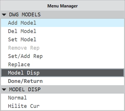

Final thoughts:
Methods 2 or 3 won't give you the "active" model, but isn't that rather transient?  The active model can change by just switching sheets.
There is also this "Hilite cur" option available which will draw a box around views that belong to the active model:
