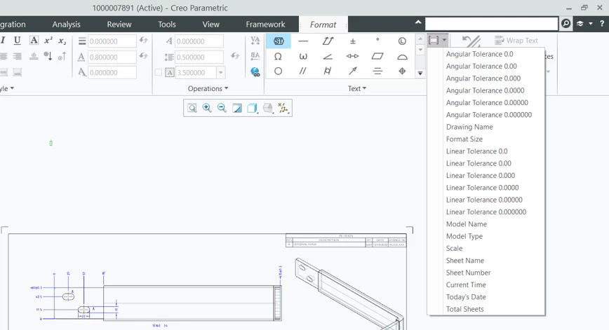

Hi guys,
to add notes in drawing i am copying text from excel, then pasting it using unattached note. i want to save my custom notes in different names under Insert filed option. to optimize the process.
Is it possible to add custom note under insert filed option. kindly help me on this, if there are any other better option please guide me.

Save your notes to text files. You can then import the notes from file.
Details on how to implement this method.
To Enter a Note from a File (ptc.com)
