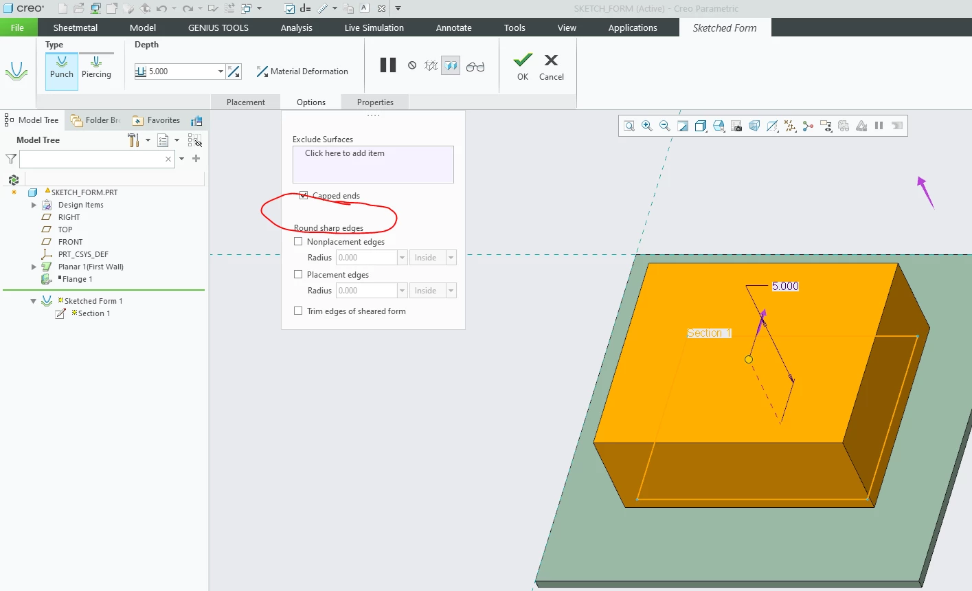

Hello I am new to Creo and I am going thru the tutorials and during the Sheet Metal Sketch Form tutorial it shows the Add Taper check box, however in my Options box in Creo 8.0 that isn't there.  Is there an option somewhere to turn this on so it shows up?  Earlier in the Fundamentals I had the same problem where the Add Taper box wasn't missing as well.

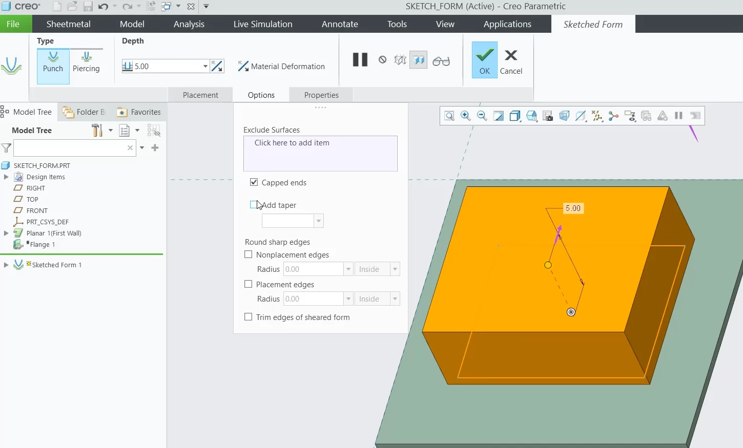

I have answered my own question by searching over and over again.  I found this https://www.ptc.com/en/support/article/CS137759
It says do this in order to disable:
Set config.pro option (select menu File > Options > Configuration Editor) enable_tapered_extrude to no
Mine was No, so I changed it to Yes and it worked!
