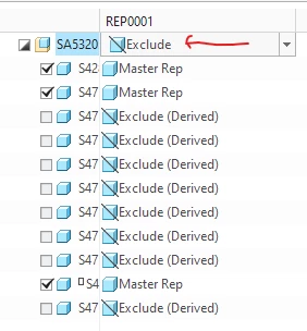

Adding components to ONLY ONE Simplified Representation Creo 7.0
I have assemblies with lots of representations.  I often need to go back and add something but I only need it in one of the representations but it adds it to all the representations.  I have tried activating the specific representation and performing the addition but it still adds to all.  Then I have to go and edit all the other representations removing the newly added component which can waste a significant amount of time. Thanks!

Not 100% positive, but this works for me.
I believe the simplified rep needs to be setup with the top level set to exclude, then turn on needed parts.  I tried it in an assembly buy making a couple Simplified Reps, activating one, adding a part, saving the rep,  and switching to the other rep.  The added part was not part of the other rep.

kdirth
Apr 21, 2023 8:22 PM UTC
If the Simplified reps are set up as I indicated, you can activate a specific rep and add a part to that rep only (and the master rep of course).

kdirth
Apr 21, 2023 7:09 PM UTC
I am using Creo 7.0.10.0, and I am able to add to a simplified rep without it showing up in other simplified reps if they are created with the top level set to Exclude.  If the other simplified rep has the top level set to Master Rep, anything added will show up.
