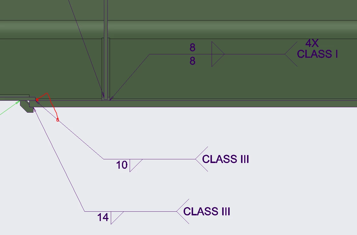

Hey guys,
I hope there is a better answer than "not possible" (using creo 4.0)
My company is new to MBD, I am detailing a very large complex weldment. I am creating the tabs, comb-states, sections, details etc. but one thing I have noticed that is driving me nuts is I cannot add a jog to the leader lines. For the weld callouts, annotations or the notes. This only applies in the 3d space. I know how to add jogs and breaks in 2d space. But cannot seem to find a work around that is quick enough to justify the effort. The image attached is just one example of why I want a jog, so I am not dragging the leader across the entire feature.

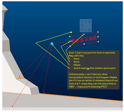

Creo-7. Right click on annotation and play: StephenV_0-1730298410784.png
Looks like we don't have much to work with in this event. Hope PTC has addressed this in developing MBD releases - it would be SOOOO nice! No doubt you already did all this but just-in-case I give this to you.
I've got Creo 10 and I've got the same options you have. You can play with the jog that's already in the note, but nothing beyond that. In weld annotations you can't do anything
