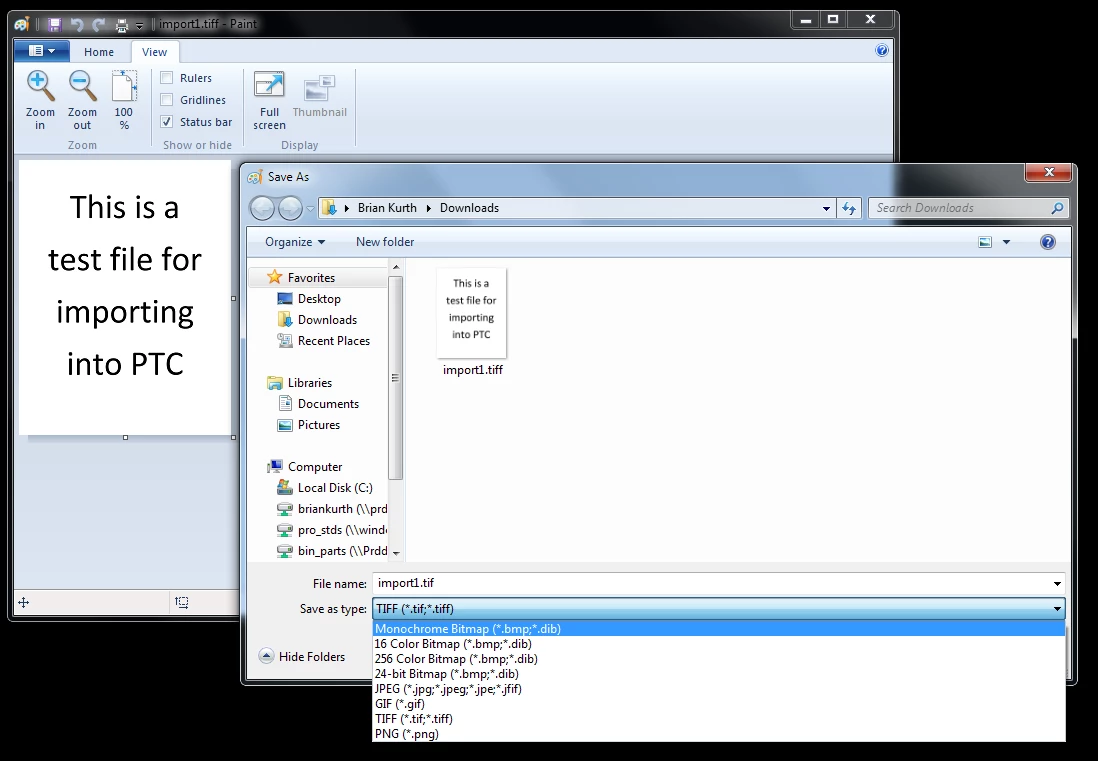

Use a TIFF file to start. It seems to be the cleanest output from many programs. Once you have your TIFF file, open it in Paint.
Once in Paint, click File >> Save as (be sure to click Save as, not one of the Save as Options that pop up if you hover your mouse).
Click Monochrome Bitmap (of if you want color, 16 Color Bitmap) It seems the higher color choices don't work consistently...at least for me.

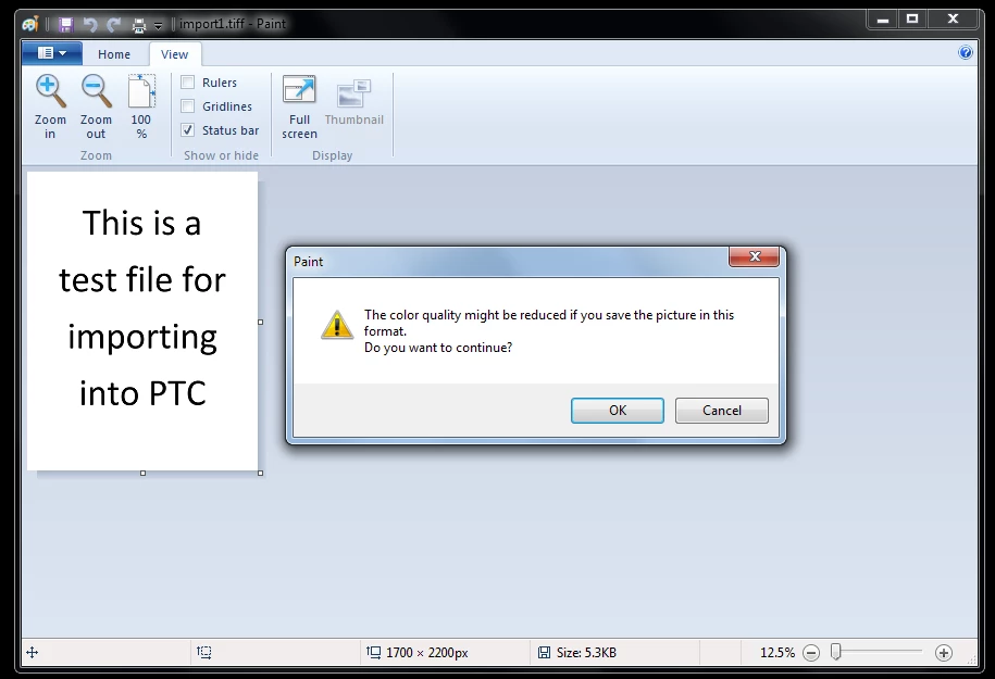

Click Save. You will get a Color Quality Message. Click Ok. You will now have a .BMP file to import.

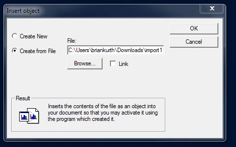

In PTC, on the Layout Tab, Click Object >> Create from File >> Locate and then double-click your saved file. Your image will import into PTC. It will probably be larger than you want it to be, but you can then scale the image and translate to size and move it where you want it to be in your drawing.

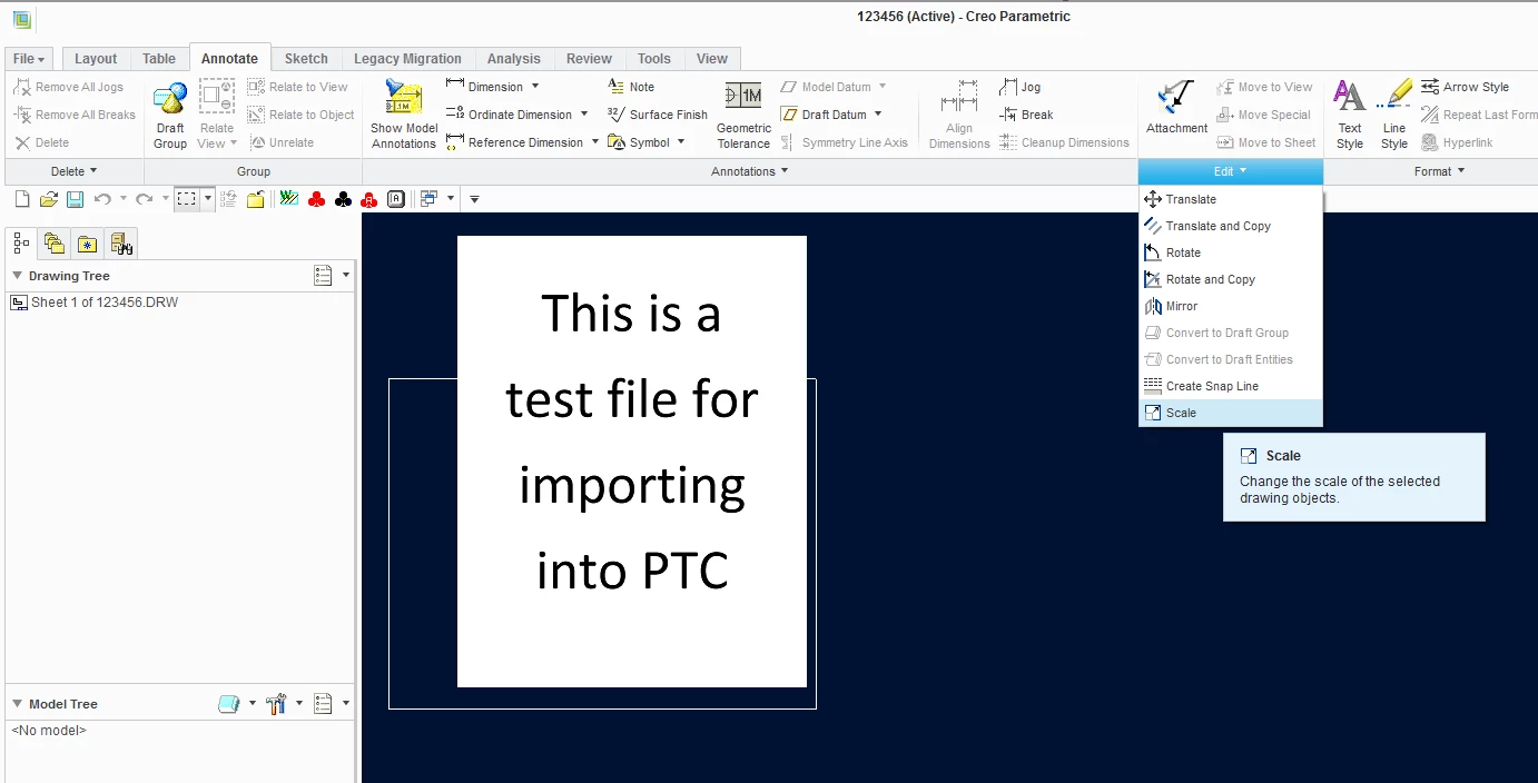

Just in case: To scale the image. Go to the Annotate Tab, Click Edit >> Scale >> Click the image,then OK, then Click a Location Point for Scaling, then type in your scale factor. Same steps to Translate the image, too.
