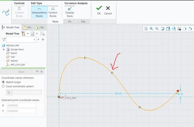

Hi, I am new to Creo. I have tried to use the Spline tool and I can't add another point OR delete an existing point upon creating a spline. I am usually forced to delete the spline and recreate it in case I want extra points or fewer points. Is there a way I can edit the spline i.e. adding another point or deleting an existing point?

I was able to figure out as per this step
  • Double-click the spline
  • Long press RMB on the spline and select Add a point
    Hover on the point and RMB to delete a point

Hi
You need to go to modify the spline in the sketch mode
After that you can add or delete to interpolation points or control points
