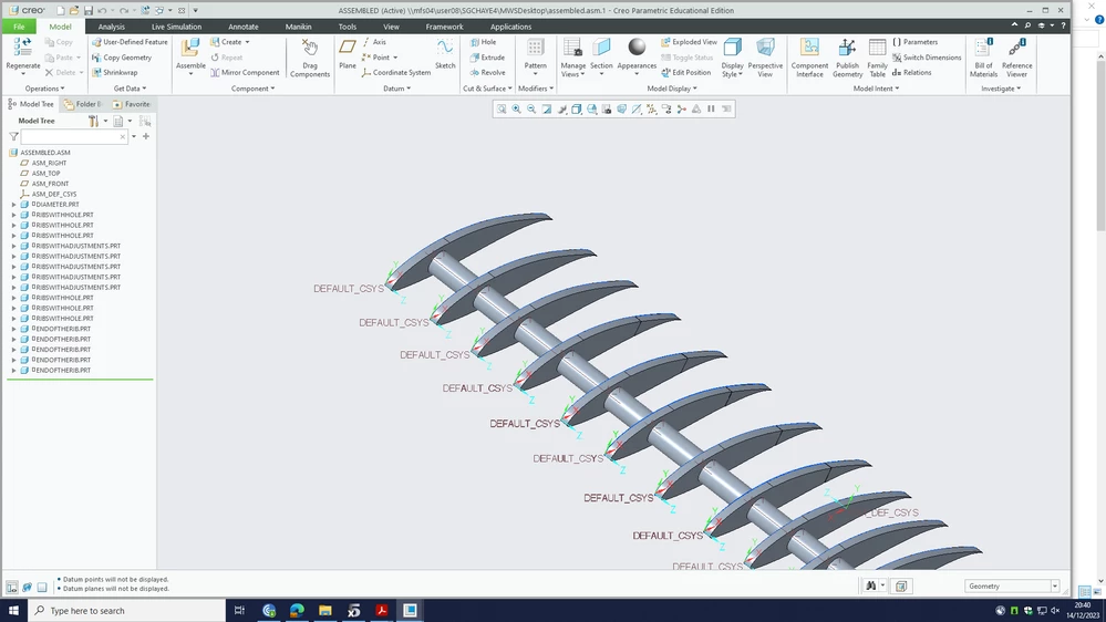

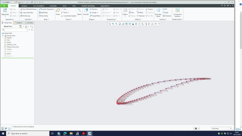

I want to create an aerofoil with ribs and spars like below. The curve that I have made doesn't allow me to extrude it, therefore I have to use the 'spline' tool to sketch over the points. However sketching over the points makes the aerofoil inaccurate. Is there any other way of doing it. I can't use the blend tool because I want to show the aerofoil in its individual parts like below.  Thanks very much.

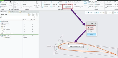

I don't know why this needs yet another new thread.  Multiple posts have been made to help you with this aerofoil.  Have you read the replies?
Have you used the Project command, as already suggested, to copy the curve into your sketch?
