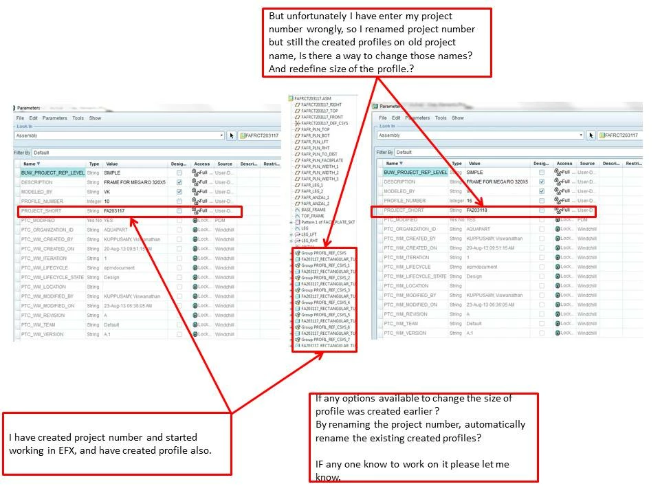

AFX OR EFX renaming project and profile size changes.
Dear all
Please kindly view the below picture.

Hello visu,
did you use AFX function to rename project? This should rename all assmebled profiles, too.
This function only shall be used without PDMLink, with PDMLink there should be functionality
in PDMLInk to rename.
To change profile section size you should go tp Profiles, then change to tab modify then select new section size and then select the beams to change.
if you have more questions or need AFX training guides send me a E-mail to stefan@buw-soft.de
Stefan
