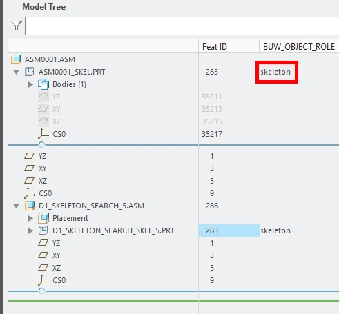

Hi @YaroslavSin ,
that will also work, but you need to take a few steps to make it happen.
  • Skeleton must be in your active assembly
  • Skeleton needs a component parameter called BUW_OBJECT_ROLE value is of your choosing, but for this example I went with "skeleton"
  • Use SEARCH_SUBCOMP_REF to find the required reference.
See structure:
See also example code:

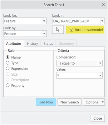

Have you attempted to include sub models in the search criteria?
• Look in (Available in Assembly and Drawing mode only) Select the active model. If the scope of your selection is already defined, this field is not displayed. The arrow button allows you to select the desired model from the graphics window or the Model Tree. Click the Include submodels check box to search the sub-models of the Look In model.

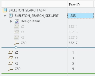

Hi @YaroslavSin ,
what you want to do is possible.
Here the Syntax:
SEARCH_MDL_REF THIS_283 CSYS CS0 CSYS_FOUND
In the elements Modeltree show column FEAT ID to get the required number after the THIS_ statement.

March 9, 2022
Hi @YaroslavSin ,
See structure:
