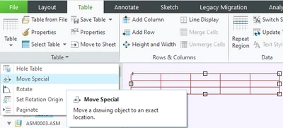

The only position control I know of, is to use Move Special.
  • Select the table
  • Select Move Special
  • Select handle on table for reference point
  • Type in coordinates to move to

Hello, thanks for the tip about the coordinates, but it's not a solution. The first table could be tied to a sketch, but to align a table to another table, you have to have at least a working vertex or something. so The first can be alligned, but not the second, i can't measure it so i can't put coordinates. There is a way to manage the tables like sketches? they are made of lines after all...
Thanks!

The first button is absolute measurement of the drawing (Our format has 0.0 at lower left corner).
Place the first table then use move special to determine location and adjust to an easy to remember number if desired.
Place second table in position and use move special to align as desired.
Another option is to turn on the sketching grid and snap to grid intersections.  The vertex you drag will snap to the grid.
