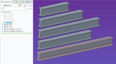

kdirth
Feb 1, 2022 2:10 PM UTC
Here is a simple example of using flexibility and inheritance.
Assembly:
First part is the base part.
Second and third part are shortened by flexibility.
     * First three parts will show up in the BOM as the same part.
Forth part is an inheritance cut to length.
Fifth part is an inheritance shortened by varying the length in the inheritance.

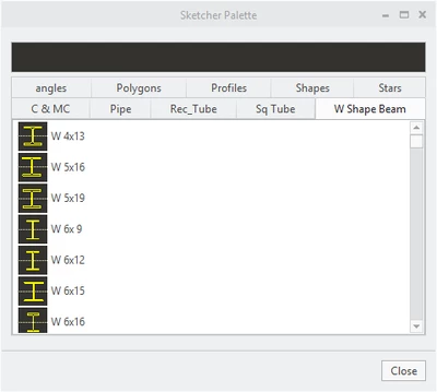

StephenW
Feb 1, 2022 12:48 PM UTC
We use the sketcher palette for profiles. So when we create a new part, we create the first feature and select the appropriate structural shape and extrude to the length needed.
