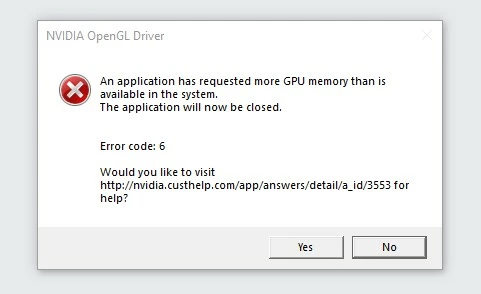

I am running Creo 6 on Dell Precision 5680 (i7-13850HX, NVIDIA RTX A1000 6GB, 32GB Ram).
When I am trying to open a STEP (500 MB) assy, Creo crushes with an error:
"An application has requested more GPU memory than is available in the system. That application will now be closed".
All the settings for Nvidia card are applied.
Tried renaming .wf folder based on one of solutions I found on PTC website, Did not work for me.
Tried other workstation, no problem.
Something to do with a Open GL driver?
Anybody had the same problem and found the solution?
Any suggestions how to fix it?

Try setting the config option graphics win32_gdi and test it on the problematic machine. See below article for details on graphics settings. via config.pro.

Added graphics win32_gdi to my config.pro. Still crushing. Opened the same assy on Dell with A3000 card, opened in a wink.
All Nvidia settings are per Nvidia suggestion. Driver is the latest.
tbraxton
Nov 27, 2023 10:17 PM UTC
Try this. On the machine where you are able to open the STEP file, save it as a Creo neutral file and then open the neutral file on the machine with the RTXA1000 card. You should also try the ISV approved Nividia GPU driver from Dell and not the one directly from Nvidia.
