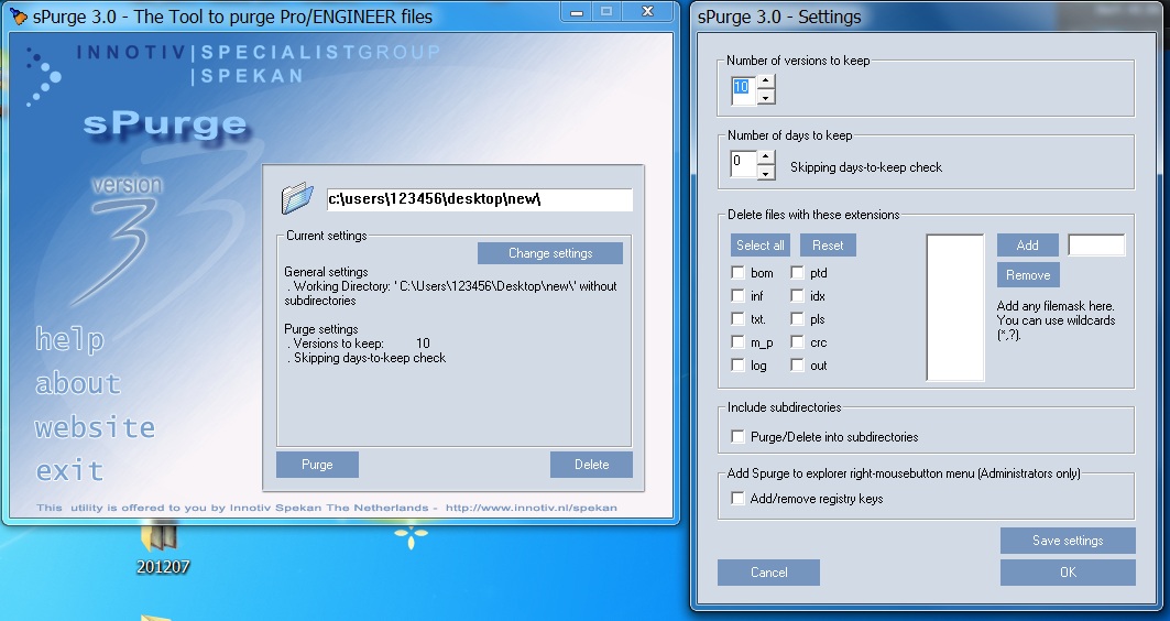

An awsome tool to purge bulk Pro/E files with ease.... <3
i know many of u need this powerful utility... i m very used to this app cause of its simple and swift work.
With this software you can also purge Pro/E files to keep only latest versions and can even rename the recent ver. Just select the root folder ans all subfolders will be cleaned.
this little program should come along or add this feature in Creo to lessen the hassle of users to manage huge number of files and disk space.

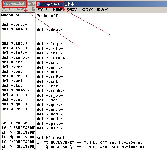

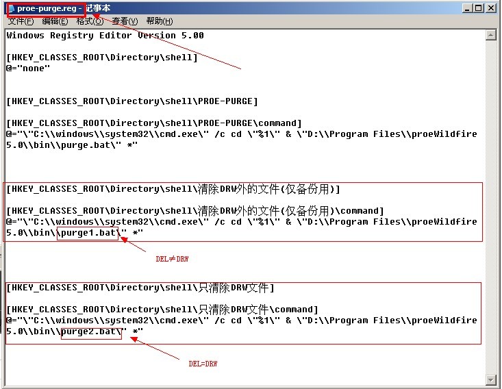

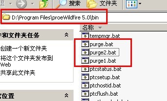

my idea(so sorry,i can not speak english):

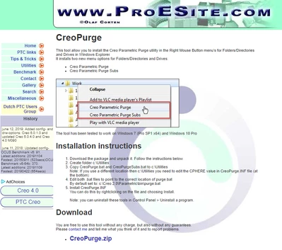

This tool worked very well for me:
http://www.proesite.com/newframe.htm?/UTIL/creopurge.htm
